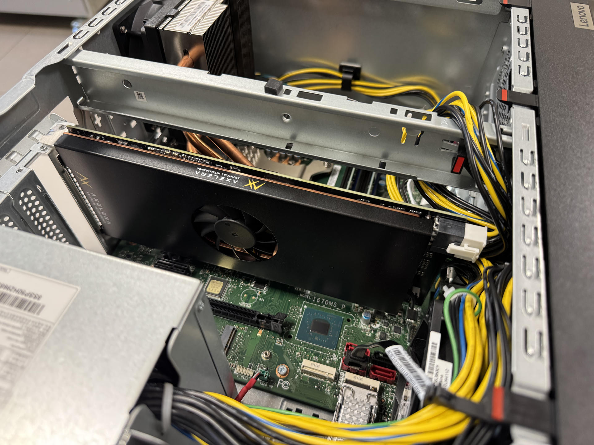

Lenovo P360
Learn more about the Lenovo P360 Tower
ItemDetail
PCIe power cable includedYes
Tested configurationIntel CPU + 2 Metis 4-chip PCIe cards

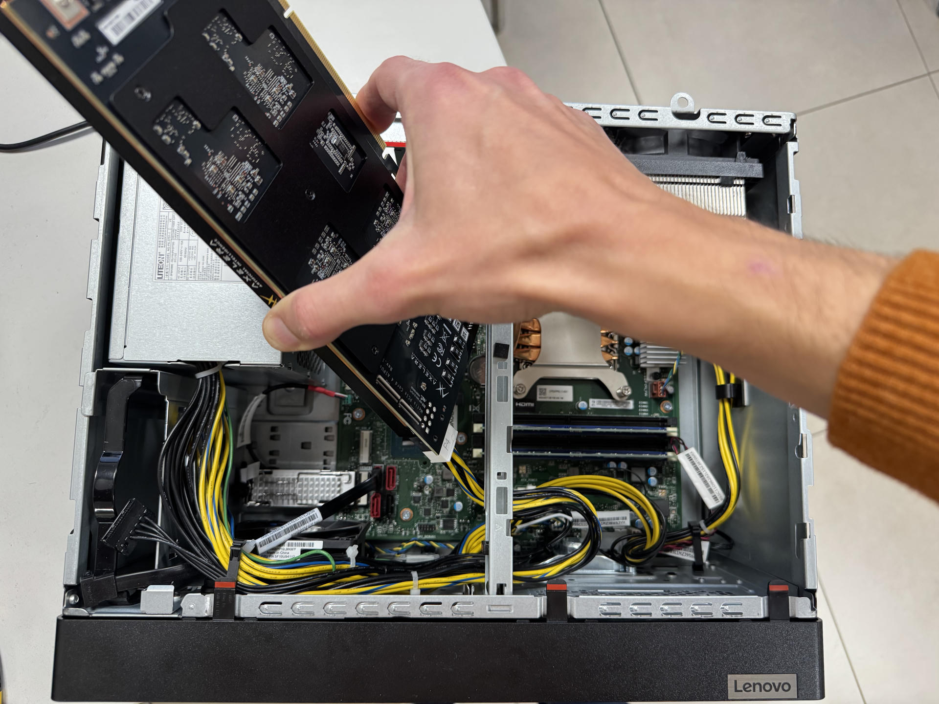

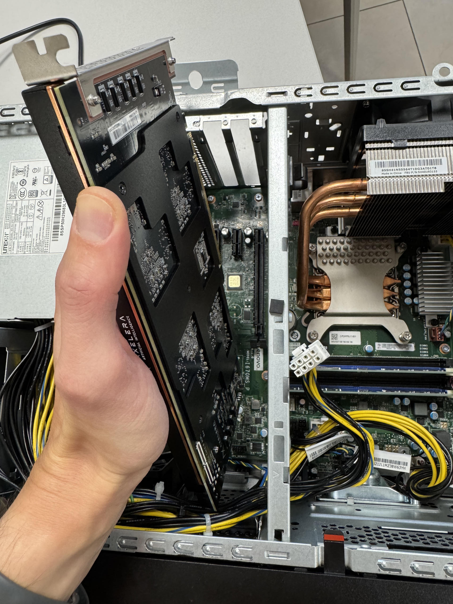

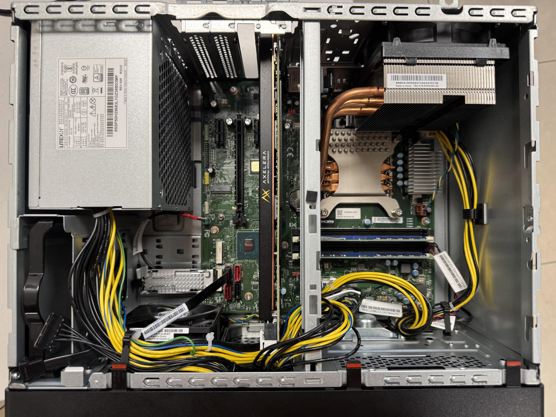

Installation notes:
  1. The physical fit in this system can be difficult. Proceed carefully; removing the backplate can make it easier (the card is large for the available space). Read these instructions and look at the accompanying pictures.
  2. Connect the auxiliary power cable before plugging the board into the host.
  3. Insert the board very carefully to prevent scratching or damaging components on the board or host.
  4. Route the power cable so it does not block airflow.
Lenovo P360 — Metis 4-chip card installation (1 of 4)
Lenovo P360 — Metis 4-chip card installation (2 of 4)
Lenovo P360 — Metis 4-chip card installation (3 of 4)
Lenovo P360 — Metis 4-chip card installation (4 of 4)

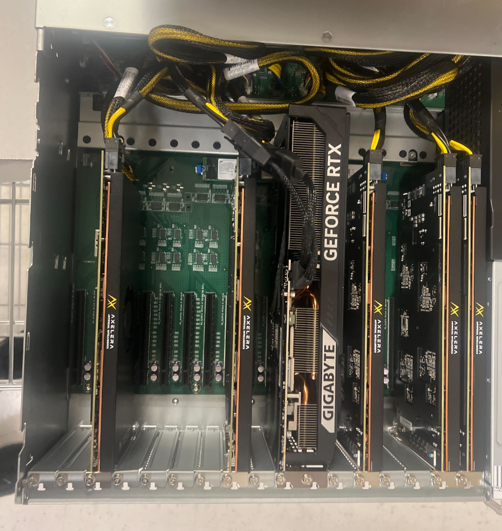

SuperMicro IoT SuperServer SYS-322GA-NR
Learn more about the SuperMicro IoT SuperServer SYS-322GA-NR
ItemDetail
PCIe power cable includedNo
PCIe power cable adapterPN: CBL-PWEX-1362-45 - converts a 16-pin VHPWR cable to a 6+2-pin cable for the PCIe 4-chip card. Available through OEM only, not through Axelera AI.
Tested configurationXeon server + 5 Metis 4-chip cards
Five Metis 4-chip cards installed in the SuperMicro SYS-322GA-NR
